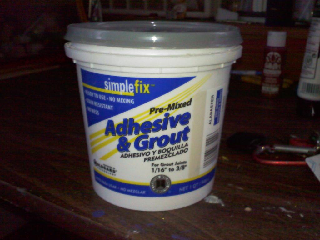

I used the Simple Fix brand Premixed Adhesive & Grout. A quart runs you about 8$ at Home Depot and depending on the size of the area you are covering it should last a long time. It comes in a few colors, White, alabaster (off white) and gray. Be sure that the grout you get is the same as pictured below--BOTH Adhesive AND Grout!

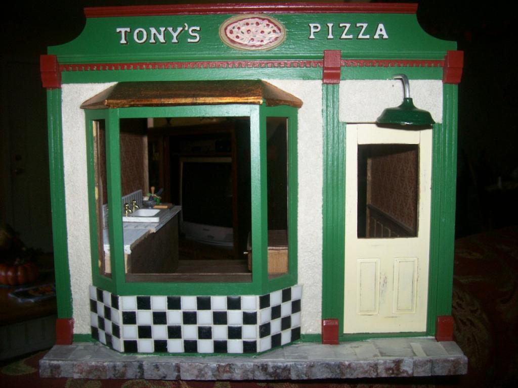

I used the alabaster colored grout on my Pizzeria because I didnt want the final effect to look stark white.

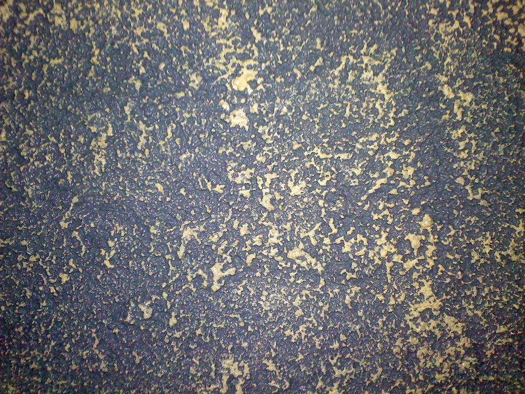

If it's necessary to color your stucco, the grout can be painted with a brush after it is dried and sprayed with a clear sealer or you can spray paint it. If you paint it with a brush you might wish to respray it with the sealer.

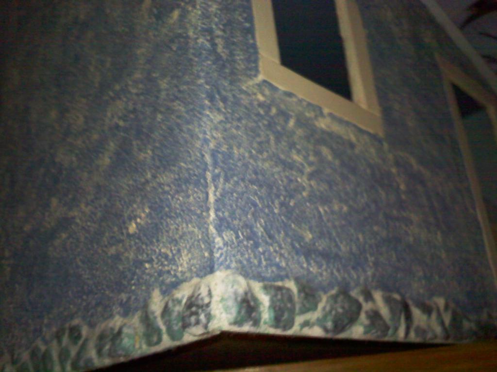

For my Loganberry Mill I used a sponge brush to work blue paint into all the nooks and crannies. Once it was done I felt the blue was too solid looking so I went back with some cream colored paint and swirled it around with a regular small bristle brush using a dry brush effect.
