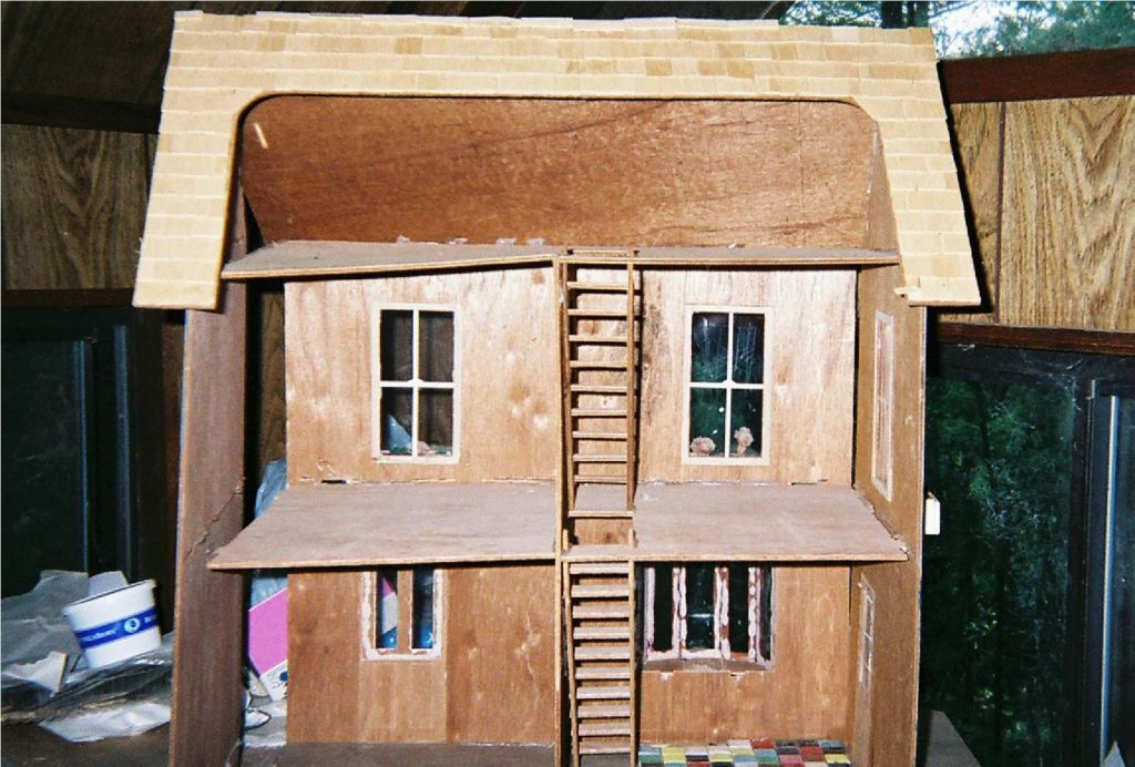

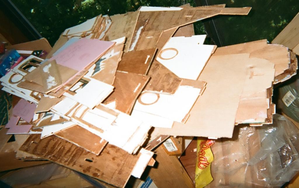

I can also tell you to stay away from hot glue. I have purchased two partially built kits while on business trips. In breaking them back down to fit flat in the box one of them practically pulled apart. The other had so much hot glue I used the hotel iron to soften and remove. Bottom line: it gets brittle and will not hold your house or shingles for nearly the length of time that wood glue will hold it.
This is the Garfield foundation before and after I pulled it apart:
[attachment=32482:garfield foundation before.jpg]
[attachment=32481:garfield foundation after.jpg]

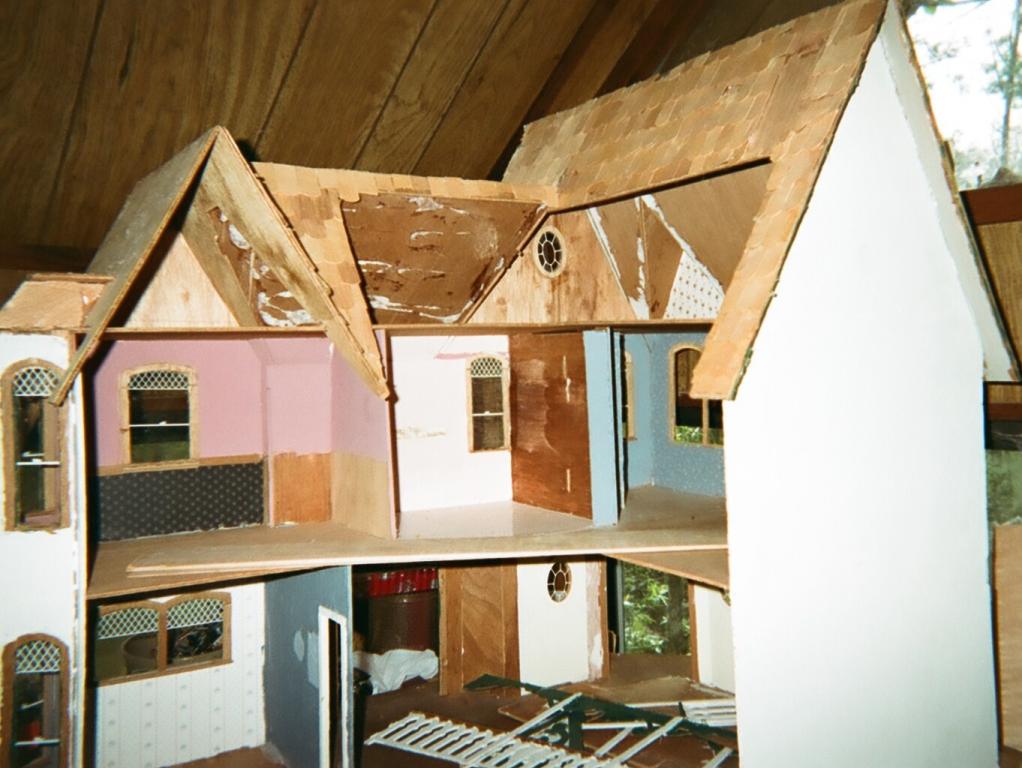

Posted 17 January 2012 - 05:08 PM
Oh, well, for that matter, here;s the Pierce I'm rehabbing before disassembling (and before I tried removing paint, windows, etc):
Posted Image
and after:
Posted Image
