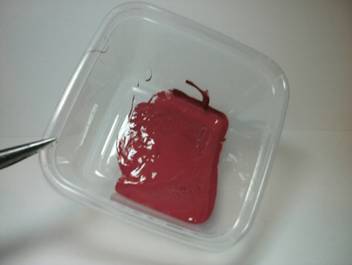

But to get back on task, let’s start with a terra cotta color paint. If you can’t find paint in the right shade, use brick red and add some drops of brown, orange, and purple; mix in the other colors with tiny drops at a time until you get the perfect terra cotta shade.

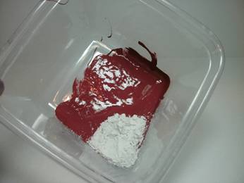

While those are drying start mixing the stucco into the paint. I add about a tablespoon at a time and stir it completely before deciding if it needs more.
The final texture of your stucco should be like frosting. It should set up just a bit if you pat it with the stir stick. If it’s too thin your texturing will fall down as it dries but if it’s too thick you’ll end up with a pot that looks like it fell into the mashed potatoes.

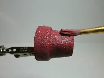

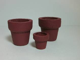

Use a clip of some kind to hold onto the pot and use a stiff bristle brush to dab the stucco onto the pot. Dabbing or tapping the stucco into place is what gives it the perfect texture. For faux terra cotta you’ll want to apply it evenly all over the pot.
Set the pots aside and let the stucco dry completely. Overnight is best but they’ll need to dry for at least 2 or 3 hours. In this picture you can see the difference in sizes of the two pots. These are the sizes most often found in craft stores. Look for them in the section of wood finials, letters, and notions.

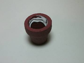

After the stucco has dried, put a little tacky glue around the inside of the pot.

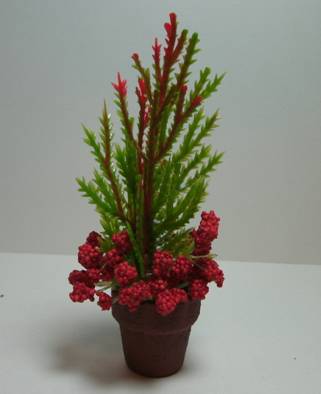

I find plants in some of the oddest places but none are any stranger than prowling around the aquarium section of the local pet and discount stores. But just look at the cool foliage I found this time! The little plastic pieces on the bottom go under the gravel to hold them in place in water but the plants pop right out of them. I was especially delighted to find these with a red tint since I’d already selected some red flowers to use.
The first thing I did was pull the plant out of the plastic, dip the end in glue, and stick it into the center of the lichen.
If you’ve looked at fake flowers in the craft stores you’re familiar with the little clusters of Styrofoam beads that have been clumped together and painted. They work nicely for mini flowers (and mini grapes if you find them in purple or green). For this arrangement, I cut off several bunches and glued them into the lichen at the base of the plant.
Finally, I cut several more pieces of the little bead clusters and glued them to the leaves all thru the plant. Voila! Flowers!
All together, it makes a nice arrangement!

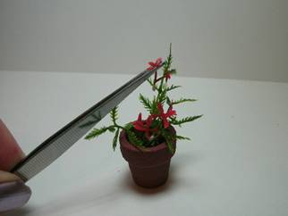

I could stop here and leave it as a pretty little green fern, but I think the red flowers are going to coordinate nicely with these leaves. Using a pair of small, sharp scissors I cut off the tips of the leaves that look like flowers and glued then onto the fern.

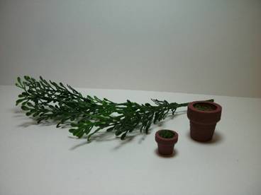

The last bit of foliage that I pulled from my stash box is a piece that will work for either 1:12 or 1:24 scale, depending on how it’s displayed. I’m using both sizes of flower pots for this one.
I did the half scale first and it was simple to do. I looked thru the stems of the plant until I found one with an attractive shape that reminded me of a rubber tree. I clipped it off, dipped the end in glue and stuck it down into the lichen.
I added a few more individual leaves around the bottom of the plant to fill it out and it makes a very respectable rubber tree plant for 1:24 scale! In 1:12 it would be a table plant, but in half scale, it’s a great floor plant.
