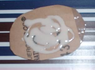

    Next, take your piece of cardboard and smear wood glue on top of it:

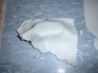

    Next, roll your paperclay to the thickness of piecrust:
    Sword in the Stone
    Scrap off the clay and lay it flat on top of the cardboard piece like this:

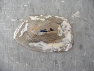

    Next you take your paint brush and pounce all over the cardboard to make the clay more shaped and defined and to help it adhere to the cardboard & foam. Be gentle but firm enough so that it looks something like this when completed:
    Sword in the Stone

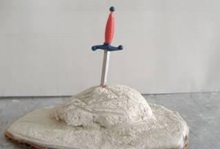

    Now, take your sword and put glue on the tip and place it in your stone:
    Sword in the Stone
    Sword in the Stone
    Next, take your blue & gold paint and paint the handle. I do this part now because of the fact that it can now stand up and dry while both sides get air so there will not be any red from the original toothpick showing.

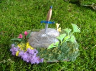

    Now add your leafy green items and flowers:
    Sword in the Stone
    Now you are finished! Enjoy building an entire scene around this:
