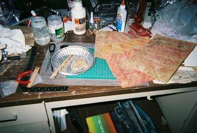

    I started out in a mellow mode rubbing pastels lightly over 240 grit sandpaper to color "bricks" and sprayed them with lacquer hairspray afterwards. I did four sheets with different combinations of colors on them. I calculated that a 1/12" scale brick face is approximately 3/16" x 5/8"; after I get them all cut I'll put them into a bag or box & shake them up really well and glue them on in random colors. I also calculated I shall have to do this sitting down with a FRESH knife blade and a SHARP pencil.

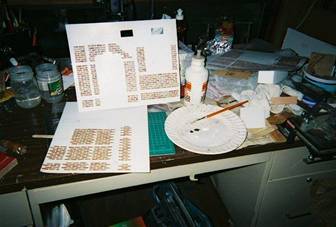

    I took the card templates and colored sandpaper sheets, steel ruler, pencil & fine-point pen downstairs to the dining room table and for two and a half hours I drew grout lines on the templates 1/4" apart and then I marked 3/16" intervals down the sides and 5/8" intervals across the ends of the four sandpaper.
    Miniature Brick

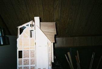

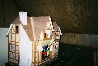

    I began "bricklaying" at 0830; it took 5 1/2 hours to glue the individual "brick" faces to the card templates and the finished product POPS!  So I painted a dirty wash of 5 parts white to one part each black & burnt umber and LOTS of water, applied it wet and patted with a tissue and it looked much better. When dry I cut out the infill areas of the bricked card and glued them to the house.
