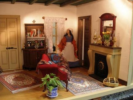

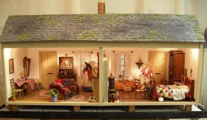

    Sometimes a little backlighting is just the perfect touch needed for a room.  Baby spots can be hidden behind furnishings or under trim to light up a room for visual delight without adding fixtures.  KathieB shows us how that’s done in her prize winning Creole Cottage.  A home for Marie Laveau, this cottage is set in an era before electricity, but Kathie shows us how a well placed baby spot adds life to the room.
