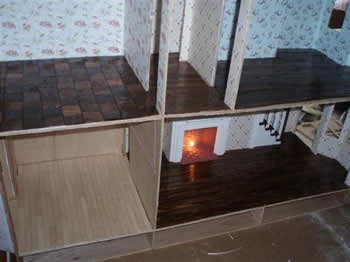

    Wendy shows us how it’s done with this combination of hardwood floors.

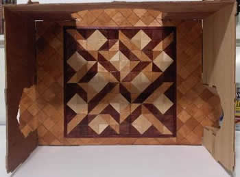

    One of the most affordable and incredible options for hardwood floors are the Greenleaf birch tiles.  The work is already done for you since they’re cut into one inch squares and can be used for a variety of styles.  A simple parquet floor can be made by just alternating the direction of the grain of each tile, or you can create an intricate parquet design with different colors of stains or cutting the squares into halves or quarters.  A great source of parquet designs can be found in quilt block patterns.

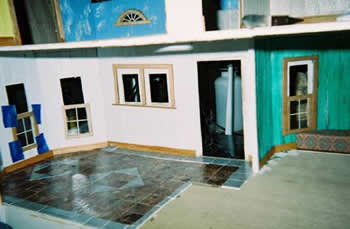

    Irene used a combination of vinyl floor tiles in her Beacon Hill and you can see the different looks you can get by choosing either 1:12 scale tiles or using a real life tile for the look of a solid marble floor.  Both are lovely!

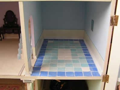

    Holly takes the Greenleaf vinyl tiles to a new level by mixing different colors for a patterned floor with a lot of flair!!

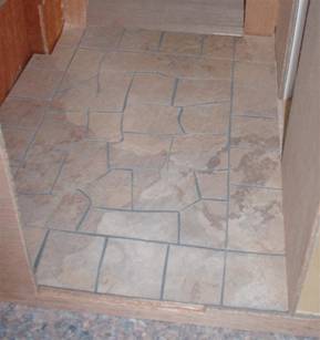

    Some houses need stone flooring and that’s an option that’s fun to create as well as very dramatic looking.   Paperclay can be used to make a unique stone floor or you can use life size vinyl tile and carve your own stone pattern into it.  Tracy shows us this Rik Pierce technique in her Coventry Cottage blog.  (you’ll need to scroll down to the bottom of the page for that tutorial)
